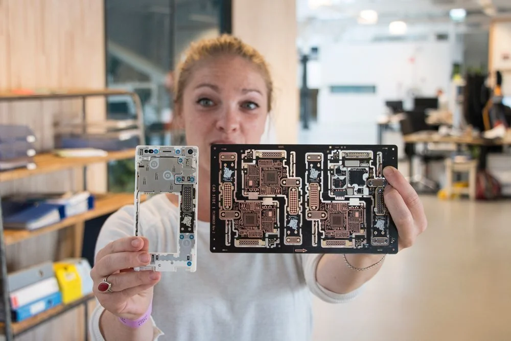

Along the way, we discovered that a smartphone contains about 30mg of gold, 6-9mg of which is found on the printed circuit board (PCB). With a very advanced view on sustainability, AT&S, our PCB manufacturer, was keen to join forces to explore the possibility of connecting Fairtrade certified gold to their supply chain – not just for the Fairphone 2 (which is calculated to be only 100 grams in gold salt for 100,000 PCBs), but perhaps for PCBs produced for their other clients, as well.
The gold found on the PCBs is applied using an electroplating process, which means that AT&S dips parts of the PCBs into a liquid solution that contains gold. The gold in this solution comes from adding grains of gold salt – so the next step back in the chain was connecting with the supplier of gold salt: Zhaojin Kanfort. After hitting a dead end with our earlier attempts to trace Fairtrade gold into China (because all of the country’s gold is traded through the Shanghai Gold exchange), Zhaojin Kanfort was able to provide us with a solution. In short, they are able to import Fairtrade certified gold through their head office in Hong Kong and then trace it to their gold salt manufacturing facility in Yantai, China.

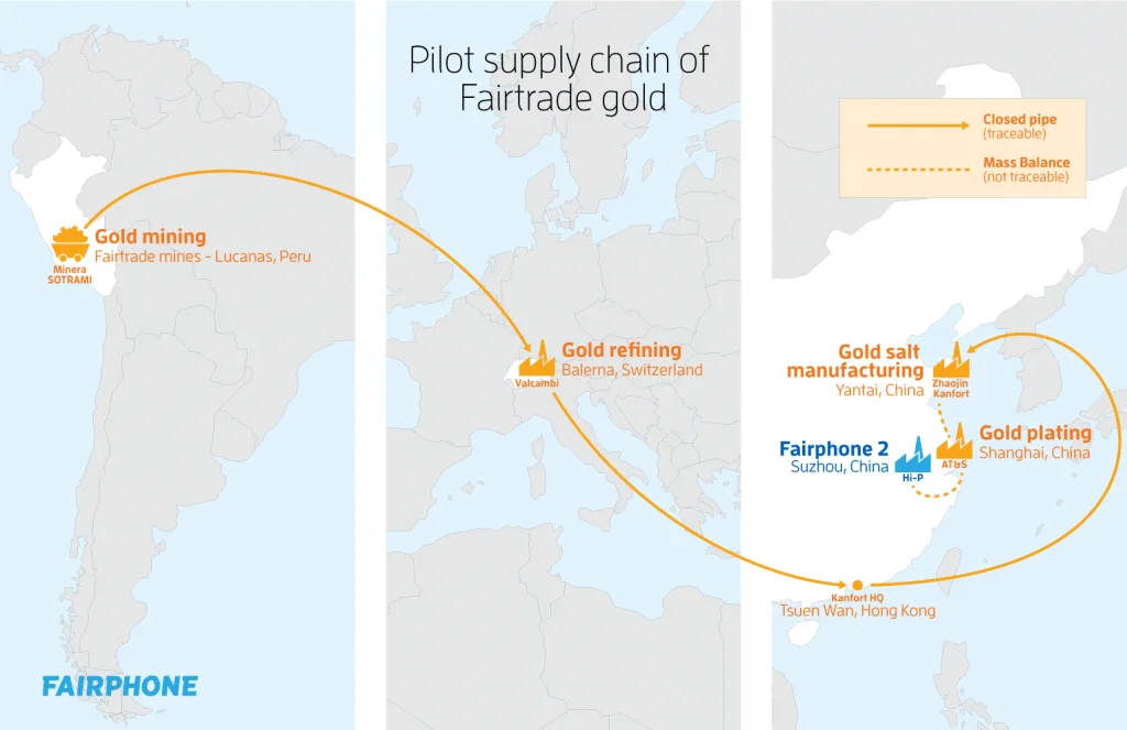

From Peru to Switzerland to Hong Kong to China: the journey of Fairtrade gold

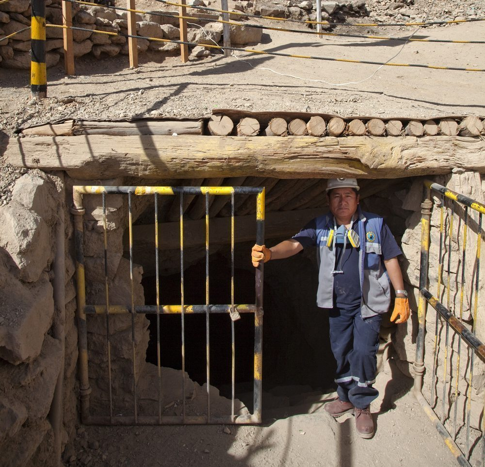

Throughout this entire pilot, we have been in touch with Max Havelaar in the Netherlands to help us facilitate the process. We will be sourcing gold from MINERA SOTRAMI S.A. (Sociedad de Trabajadores Mineros S.A.) in Peru. MINERA SOTRAMI has 164 shareholders and employs 260 mineworkers as well as five engineers who manage the mine and processing plant. The gold mined here meets the Fairtrade Standard for Gold and Precious Metals, meaning that rigorous social, economic and environmental regulations are followed including child protection policies. In addition, the miners are guaranteed a Fairtrade Minimum Price and Premium that assists in sustainable development for the community. This way, the mine supports 500 families.
Minera SOTRAMI. Inside a Fairtrade certified gold mine in Peru
After leaving Peru, the gold travels to Valcambi a major refinery in Switzerland that is licensed to process Fairtrade certified gold. Once it’s refined, we purchase a small amount of the gold which is shipped to Kanfort’s office in Hong Kong, and then finally exported to Zhaojin Kanfort’s gold salt processing facility in Yantai, China. There the Fairtrade certified gold will be mixed with gold from other sources (referred to as mass-balance) to create the gold salt used by AT&S to electroplate the PCBs.
Pilot supply chain of Fairtrade gold
