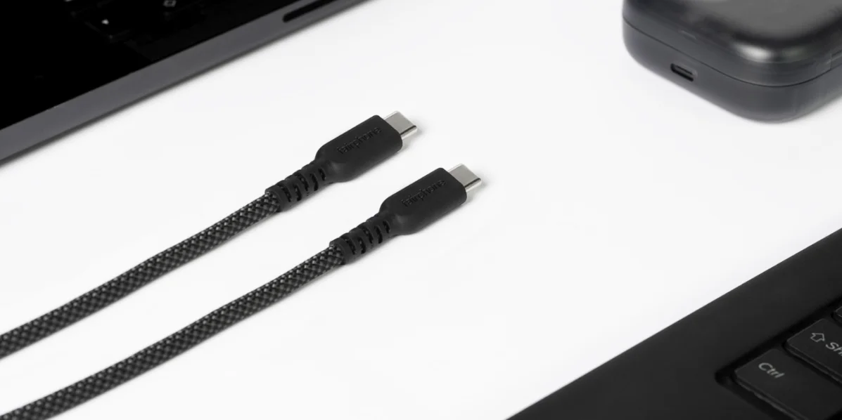

The Fairphone USB-C 3.2 Long Life Charging & Data Cable
Charging outputs up to 240W. Transfer speeds up to a whopping 20Gbps. An integrated USB-A adapter. The USB-C 3.2 Long Life Charging & Data Cable works perfectly with almost any electronic device, and is easily our strongest cable as well, successfully clearing over 100,000 bend tests. With a three-year warranty, the LONGTIME® certified cable is also designed fair, with over 55% fair and recycled materials inside. It’s also made in fair factories, supports living wages for factory workers, and is assembled using 100% green energy. Oh, and it’s a 100% e-waste neutral too.

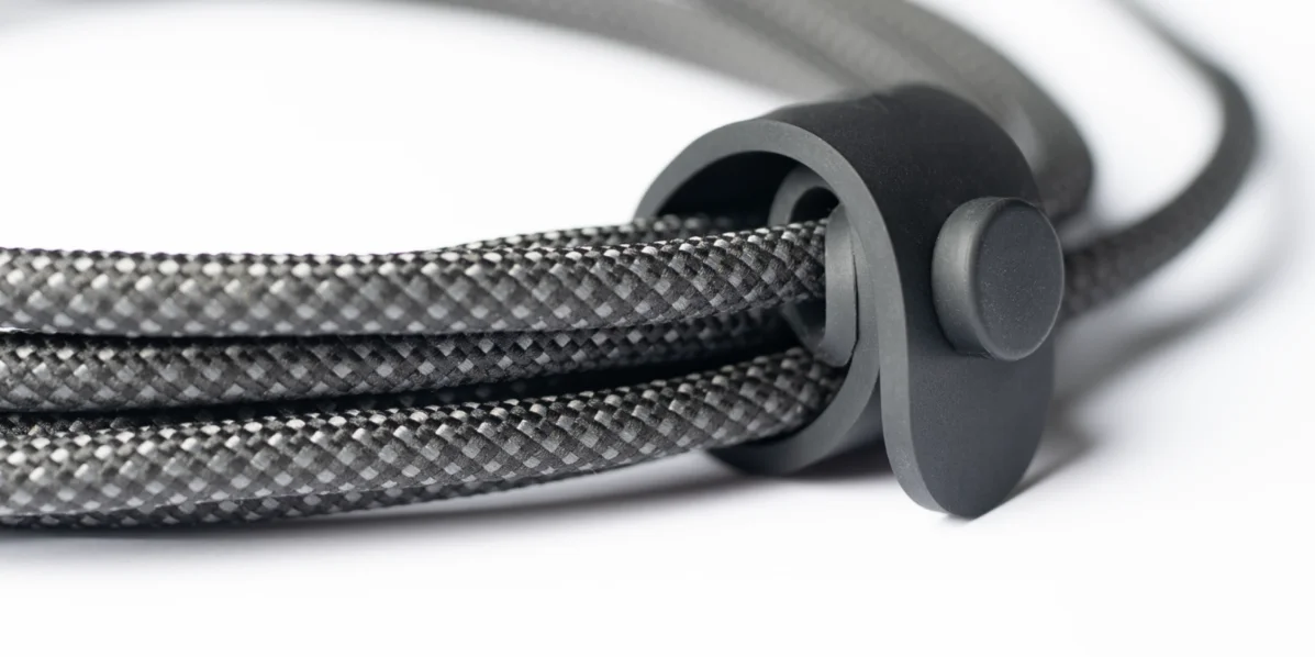

The Fairphone USB-C Long Life Charging Cable
With an output of up to 240W, the Fairphone USB-C Long Life Charging Cable is your go-to when you want to power up your devices with little time to spare. Thanks to the integrated USB-A adapter, it is compatible with almost any electronic device with a USB port. It is also stronger than the competition, successfully clearing over 70,000 bend tests. With a three-year warranty, the LONGTIME® certified cable is also designed fair, with over 55% fair and recycled materials inside. It’s also made in fair factories, supports living wages for factory workers, and is assembled using 100% green energy. And just like its USB 3.2 cousin, it’s a 100% e-waste neutral too.

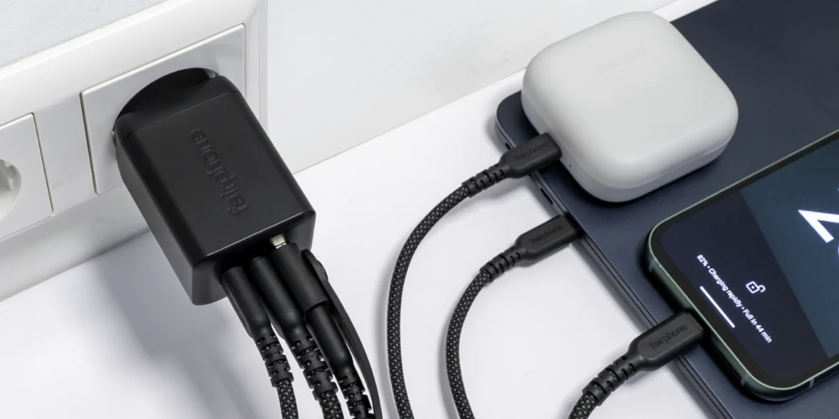

The Fairphone 65W Triple-Port
Fast Charger
65W Triple-Port
Fast Charger
Simultaneously charge up to three devices, including your laptop, using the two 65W USB-C ports plus one 30W USB-A port. Your devices stay protected as well, thanks to built-in short circuit protection and advanced temperature, current and voltage control. It’s LONGTIME® certified, and comes with a three-year extended warranty, so you know this charger is built to last. Our new 65W charger stays true to our sustainable design approach. It’s 100% e-waste neutral, and contains 98% recycled plastics, plus recycled copper-zinc alloy in the plug pins. It’s also made in fair factories, supports living wages for factory workers, and is assembled using 100% green energy.

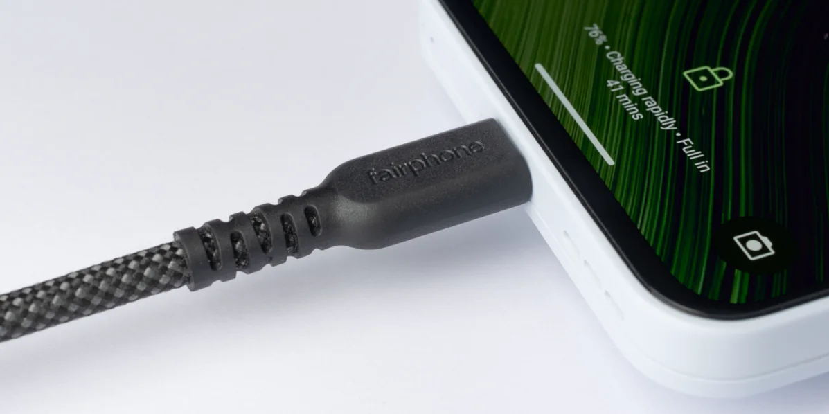

They definitely sound sturdy and durable. The cables especially have some insane bend-test stats. The USB 2.0 cable’s cleared 70,000 bend tests, while the USB 3.0 cables survived a massive 100,000 tests! What’s that all about?
The benchmark for a very high-quality data or charging cable in the industry is 20,000 bend tests. That was what was accepted industry-wide until now. After our initial brainstorming, we had a clear concept in mind. These cables had to really, REALLY last. We had countless discussions with our engineering, quality, and impact team to see how far we could go. In the end, we set a crazy target for ourselves: 100,000 successful bend tests! Translated into user behavior, this means the cables survive for at least ten years. That’s a good enough window to account for changing technologies and new USB standards. What was interesting is that the footprint involved in going from 20,000 successful bend tests to 100,000 has been not that big.
The new cables are strong and durable, clearing between 70,000 to 100,000 bend tests successfully.
