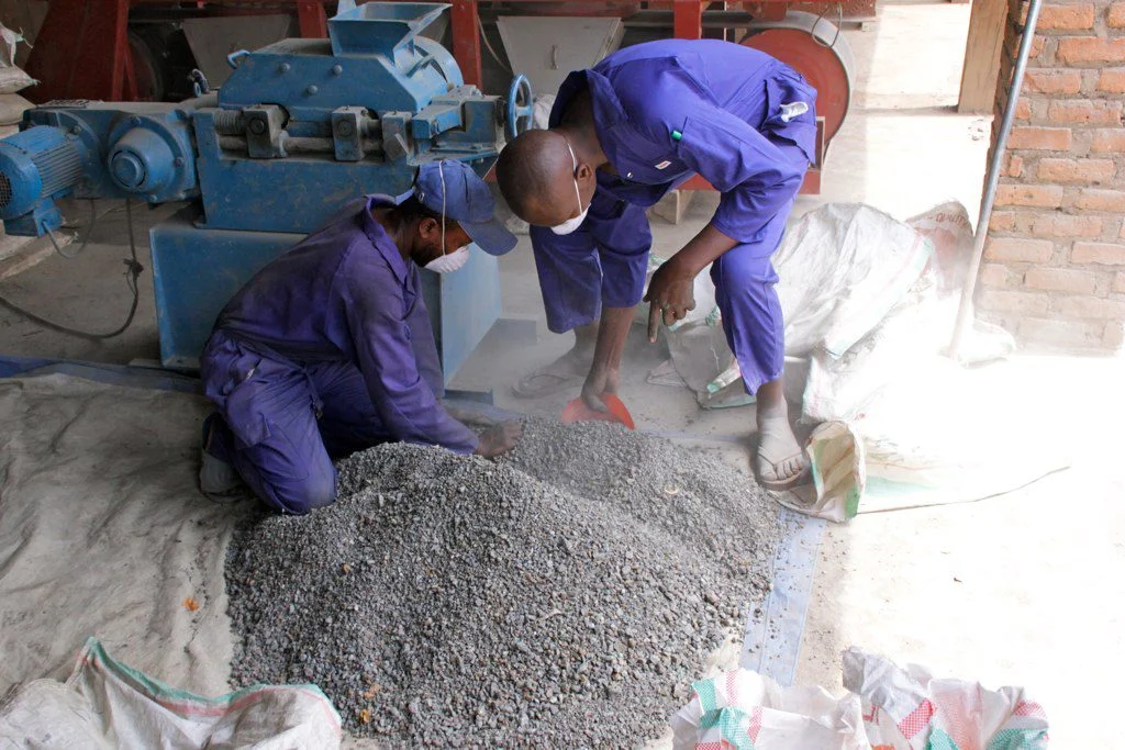

  • Mineral: Cassiterite

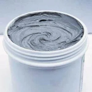

  • Purpose: used for soldering, or joining components together like glue
  • Shape: paste, similar to peanut butter
  • Properties: very conductive; can quickly change from liquid, into dried material that hardens for use
  • Use: for attaching components on the main board, called the PCB (printed circuit board)
Conflict-free tin is sourced through the CFTI in a closed-pipe supply chain, which means it is “a conflict-free design, piloting new tracking and tracing procedures to ensure the conflict-free status of the supply chain.” Once this tin (cassiterite) has been extracted, it goes to a company that makes soldering paste (that jar of peanut butter). It’s not just tin, but also silver and copper that go into this soldering paste. It looks something like this:

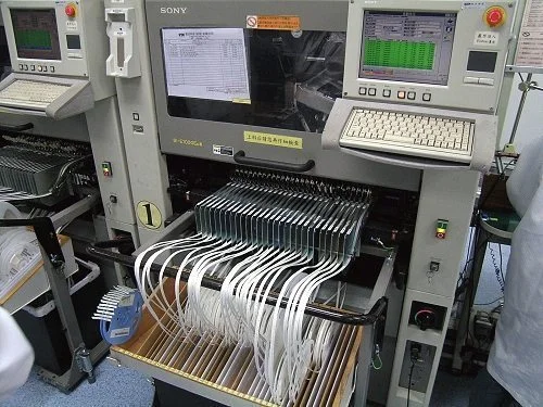

This jar of paste (conflict-free!) is sent to our production partner, where the glue will fix or attach many different components onto the main circuit board by, in everyday terms, a robot – if you really wanna know this part is called SMT (surface-mount technology). I want to stress the conflict-free initiatives FairPhone engages in are sourcing minerals from DR Congo. What some other companies are doing, especially after Dodd-Frank, is to leave Congo and to find “conflict-free minerals” from somewhere like Australia. FairPhone’s decision to work in Congo, on the other hand, comes from the vision to source from areas that need our continued economic support. FairPhone wants to work in these areas where we can work to improve and contribute to the situation – we want to change rather than avoid these issues in conflict areas.

Small capacitors are stuck on the white roll, that looks like paper, which the SMT (surface machine technology) machine takes one by one.

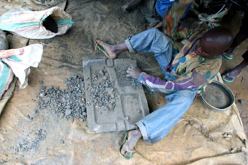

  • Mineral: Coltan

Since tantalum is being sourced by Solutions for Hope this means their approach “utilizes a closed-pipe supply line and a defined set of key suppliers – mines (including artisanal cooperatives), smelter/processor, component manufacturer and end user – identified in advance of initiating the project.” After engaging in this closed-pipe chain, the tantalum metal comes to a company that makes capacitors. There are different types of capacitors used for one thing or another, so not all capacitors are made from tantalum. The function of capacitors is to create small electricity storage in certain parts of the printed circuit board. Again, these capacitors – packaged in a roll and sent to the factory – are placed on the circuit board with the SMT robot.
